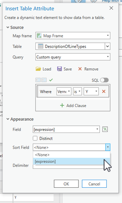

@AubriOtis is there a limit on what type of field can be used to Sort? My dialog is not offering any field names in that dropdown.

AubriOtis
@CRose that's interesting. It can sort by text or numeric fields. Blobs don't work, and I don't think date fields are supported (but I may be misremembering). What other field types are in your table? How many fields are you expecting to see?

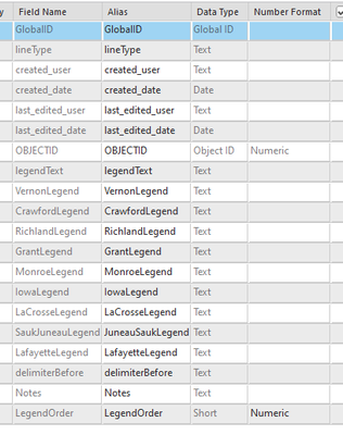

CRose
I had created a "Short" (integer) type field called "LegendOrder" to use for this purpose, but it doesn't appear in the sort dropdown. None of my twelve text fields appear in the Sort dropdown either.
AubriOtis
Ah, I see what's happening. Your field is an expression. When you are returning an expression instead of a field the values might not match the values in the table. The potential for mismatch means a field can't be used. You can sort by the expression, but that's all.
CRose
Ah, ok.
I expected the Sort option to be independent of the "Field" that is displayed.
My field expression in this case is just a concatenation of my "delimiterBefore" (usually but not always a new line) and my "legendText" attributes. I this case I may be able to restructure my table rows to use the delimiter in this dialogue instead.
