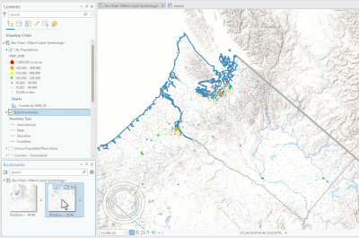

@TysonPhillips from what you've described, would bookmarks work? Bookmarks store the rotation so when you zoom to a feature by going to it's bookmark, you get the desired rotation.
TysonPhillips
@KoryKramer I am not aware or familiar with Bookmarks. I will definitely be checking them out! They look like they would do what I'm looking for. Thank you!

Closing this for now as it seems bookmarks will provide the needed functionality.
