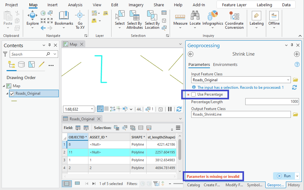

Just a heads up:
There seems to be a quirk where the Use Percentage parameter is mandatory -- even though leaving it unchecked is a valid scenario.
But I can work around it by enabling that parameter, then disabling it.

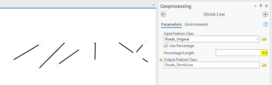

Never mind. I see now that the percentage needs to be a decimal like 0.3. Not 30 percent.
Using .3 works as expected:
