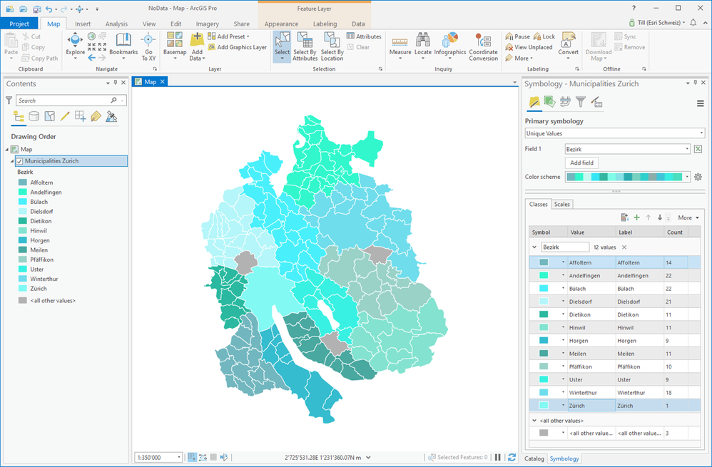

In ArcMap one could see the feature count of <all other values> when configuring symbology but showing <all other values> in legend was deactivated.
In ArcGIS Pro when showing <all other values> in the legend is deactivated it is deactivated as well in the Symbology Pane and therefore the count of features out of range is not visible.
When “Show all other values” is activated it is visible in legend and in Symbology Pane:

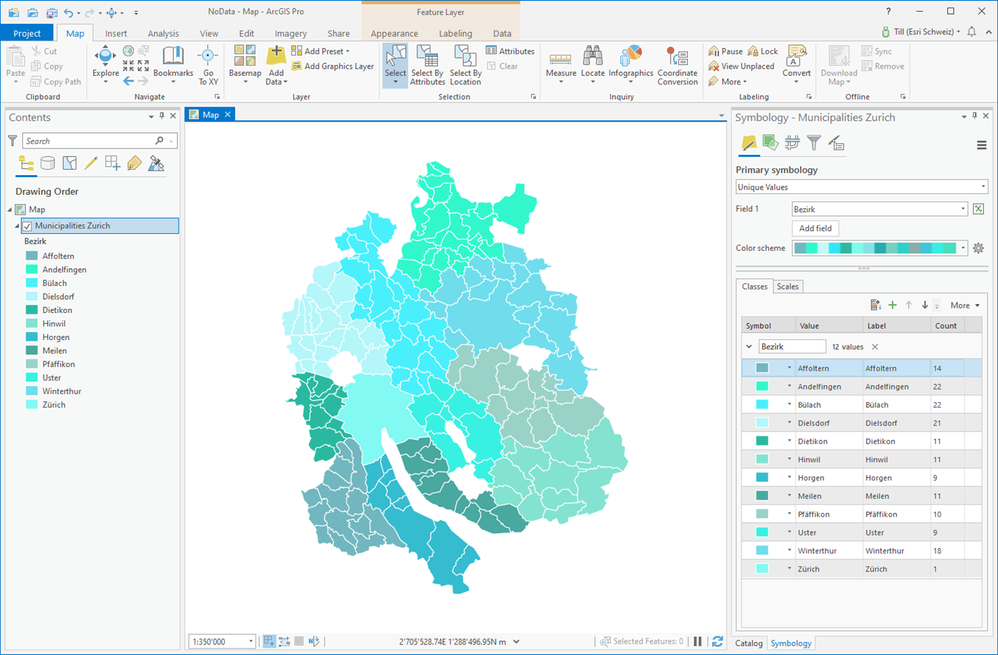

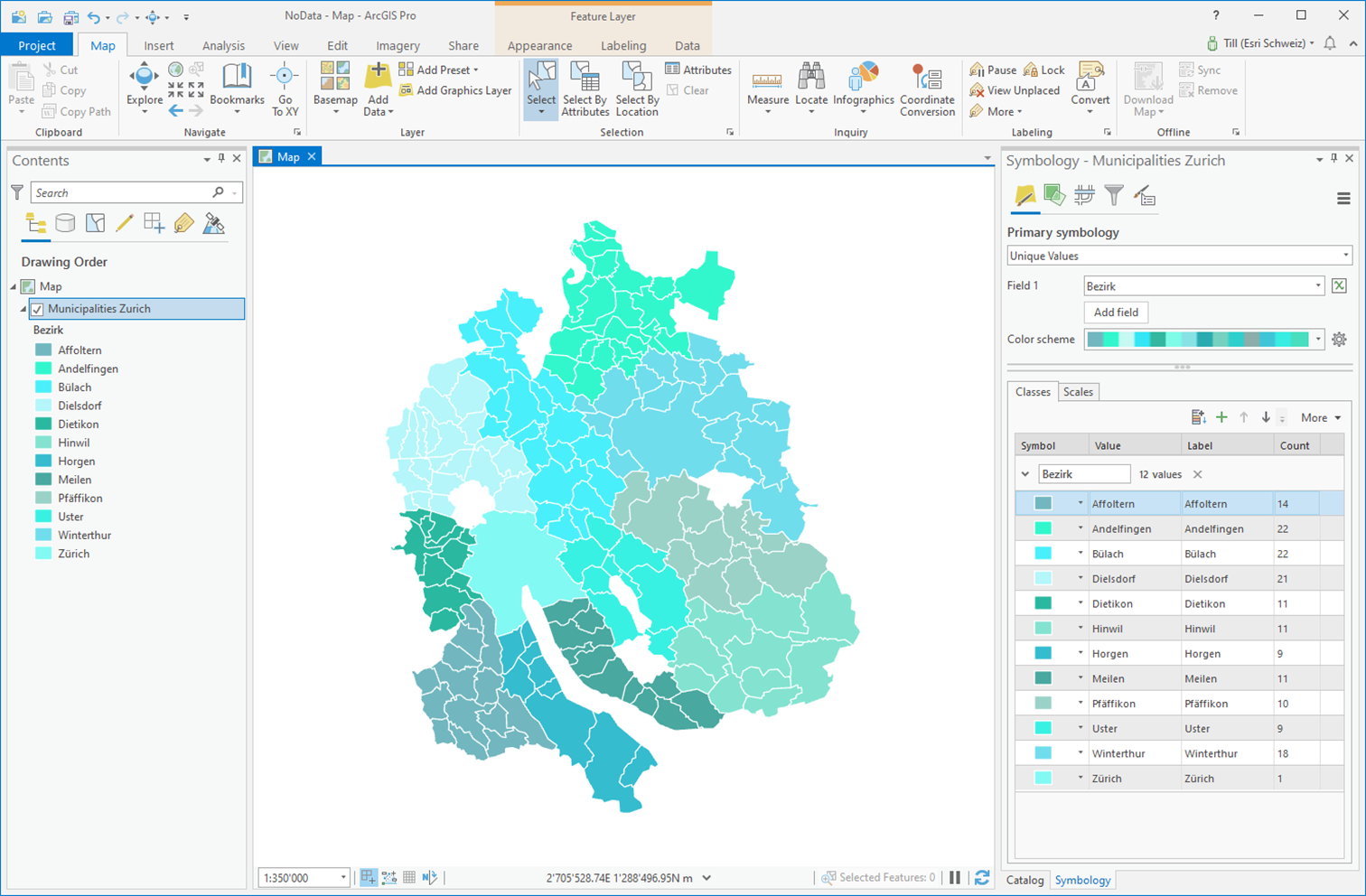

When “Show all other values” is deactivated it is invisible in legend and in Symbology Pane:

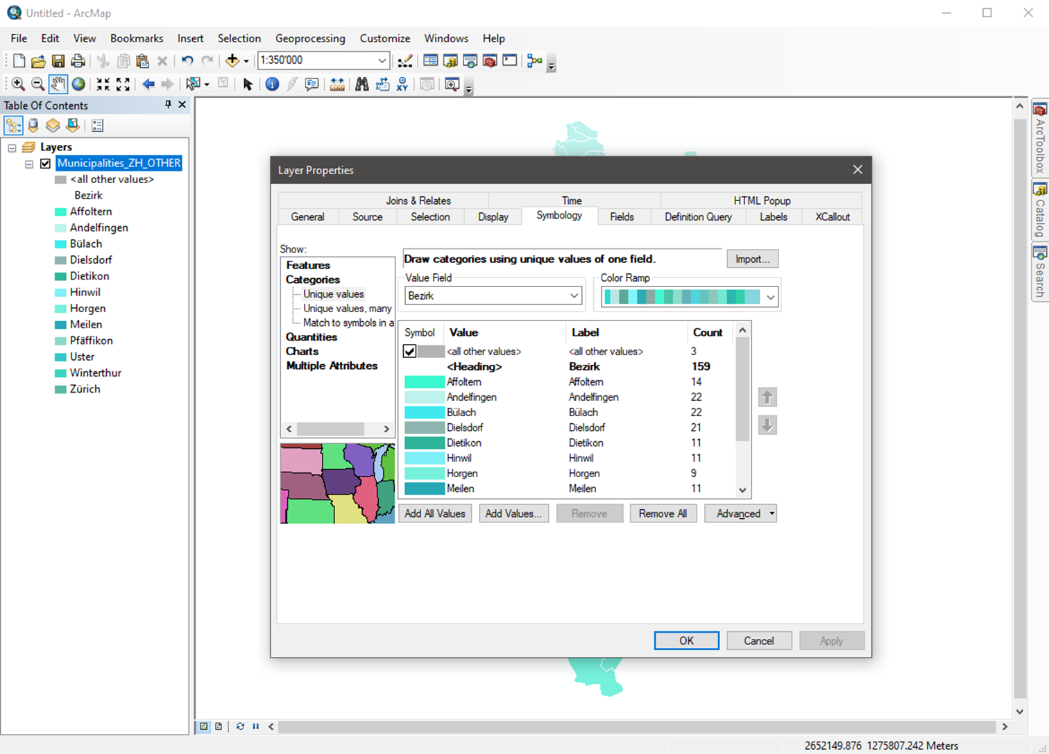

When <all other values> is checked, it is visible in the legend and in the layer properties:

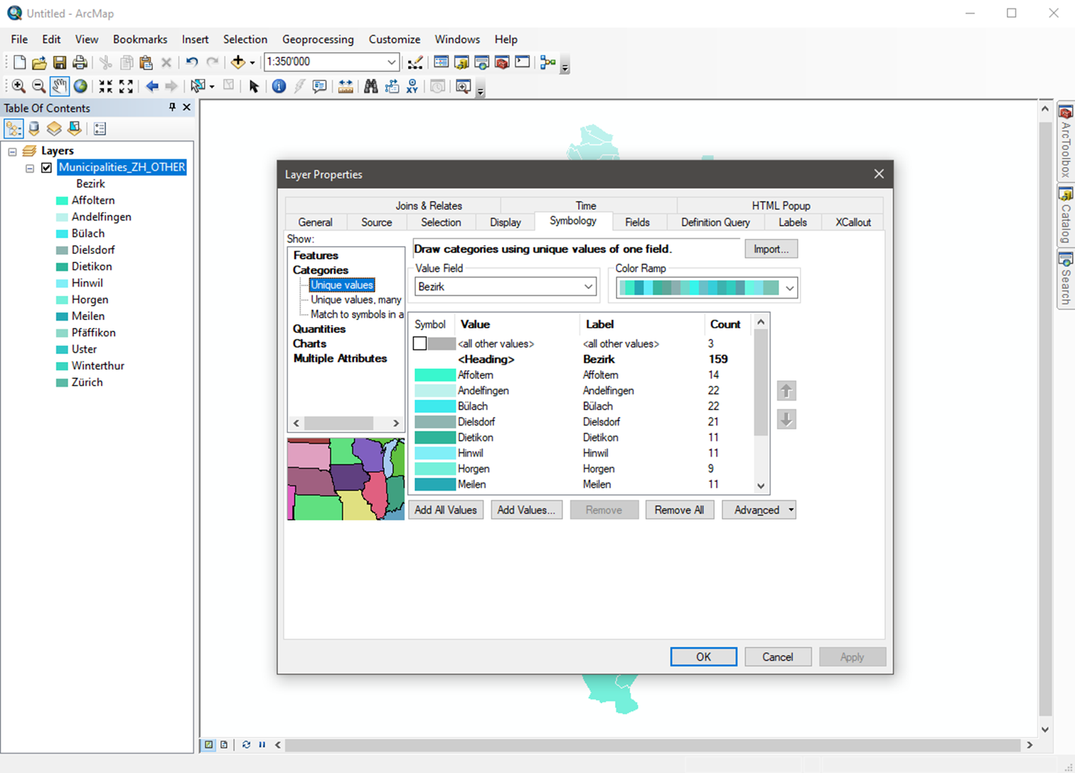

When <all other values> is unchecked, it is not visible in the legend but still in the layer properties. Especially the feature count:

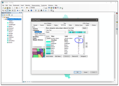

Hi RMaron, for the description you put in this issue "Show the total count of all features in the Symbology Pane", do you mean to show the total count of all features or the total count for all unique values? Since you could use the attribute table to view the amount of total features of the layer.
Thanks!

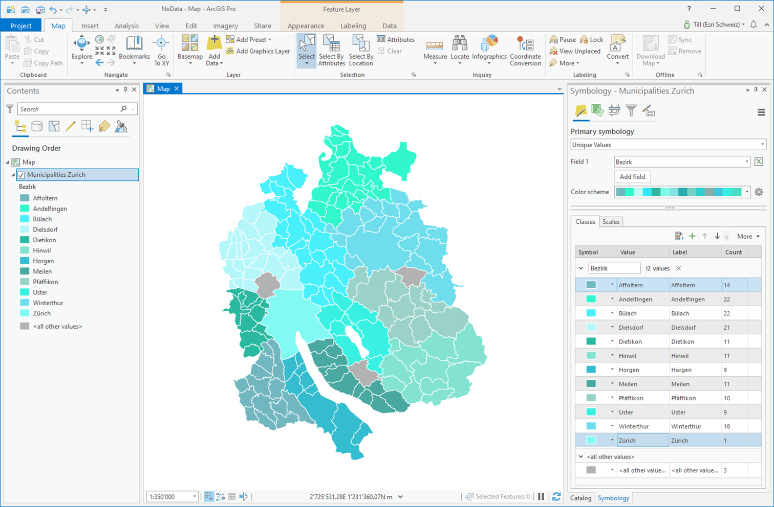

TillAders
Hi @Zihan and @RMaron
I think best would be if it would be the same as in ArcMap:
As far as I know this is the total count of all unique values.
Cheers
RMaron
Hello @Zihan and @TillAders
Sorry for my late reply, I was on holiday....
I agree with Till, it should be the same as in ArcMap: The total of Unique Values. All others are then counted under "all other values".
In the case of only one heading and if all occurring values are listed, the total is of course also equal to the total features of the layer. In the case of several headings, the total of each heading is shown separately (see marking on Till's screenshot).
