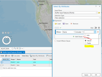

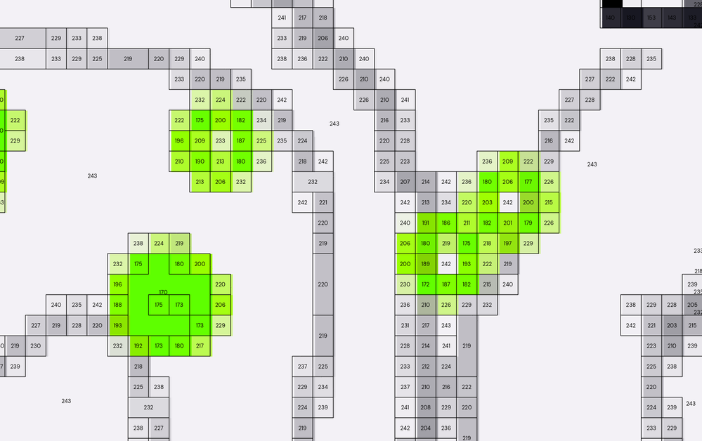

It would be useful if you could quickly select all matching features based on a field attribute. For example, in the image below I want to select the polygons that are green, but I don't want to have to list all possible entries in a Select by Attribute process, I'd like to select a few manually and then be able to select all matching features with the same field attribute.
9 Comments
leahmaps
Do you have a common attribute that makes all of the polygons green?

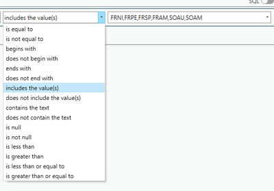

Have you done something like, "Select by Attribute" and then utilized the different SQL options?
This way you can try to find similar features based on text contained in the attribute fields.
JonathanNeal
@leahmaps I was thinking doing the includes the value(s) option too, but adding an enhancement to use only selected.

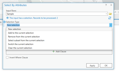

leahmaps
@JonathanNeal, wait, but isn't that how includes work? In the screenshot above, any attribute that includes "two" in the name field would be selected.
Additionally, above in the selection type, you could choose to replace "New Selection" with another option to fulfill the selection.
Does that solve anything, or am I missing what you were trying to get across?
JonathanNeal
@leahmaps Apologies, don't mean to confuse or be unclear.
The user's intent was "two" should not show up since it is not selected, then doing a new selection select the rest of the features with those attributes.
  1. Select these values on the map.
  2. Select the rest of the values of those I currently have selected.
My thought is that we can add a new toggle named "Selected Values" under "Values" (Where I have highlighted) so that only the value "one" would show up in the dropdown and "two" would be filtered out.  The internal discussion on this one is leaning towards a script tool which we can provide shortly.
The selection type options wouldn't be helpful to finding the distinct attributes that are in the currently selected features.

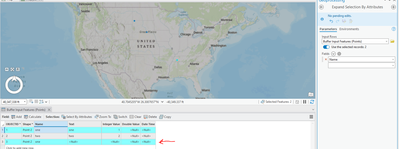

JonathanNeal
@RSL Here you go: https://www.arcgis.com/home/item.html?id=cfb81e51a02743cbb0e8a2d6dcfdc5c9
(Thanks @DrewFlater )
Usage:
  1. Select your features on your map.
  2. Run the tool using the layer with the selections and use the fields you want it to match.
    Note: in my screen shot I have ObjectId 1 selected and after running the tool both objectId 1 and objectId 3 are selected using the Name field.
