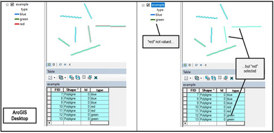

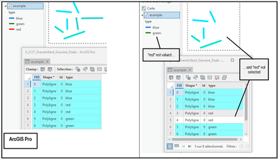

When i use unique value symbology, i can choose to not symbolize all values.
But then i can not graphically select the features that aren't valued/symbolized/visible on the map.
On ArcGIS Desktop it would select all the features, regardless of the symbology.
I can see the purpose of Pro's version, and sometimes it's useful, but sometimes not.
> Please make possible to select all the features in the map window, including those which are not displayed with the layer's symbology.
