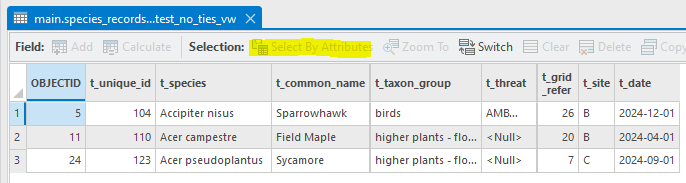

Bud
Mobile Geodatabase:
I have the same table and the exact same database view as the Oracle view above in a mobile geodatabase. However, the Select By Attributes button is greyed out in the attribute table.

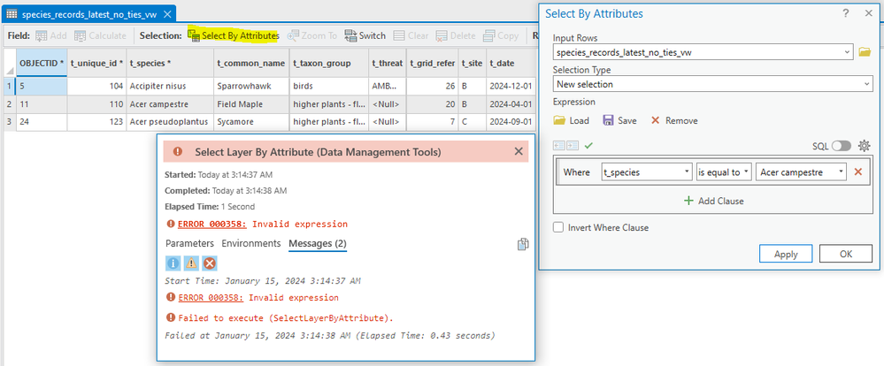

File Geodatabase:
I have the same table and near-identical database view in a file geodatabase. The only difference in the SQL is a slight difference in the field aliases. Reason: FGDB views seem to prefer slightly different syntax when it comes to those aliases.

The Select By Attributes button is available, but it throws an error.
ERROR 000358: Invalid expression
Could Select By Attributes functionality be added for mobile and file geodatabase views too?
