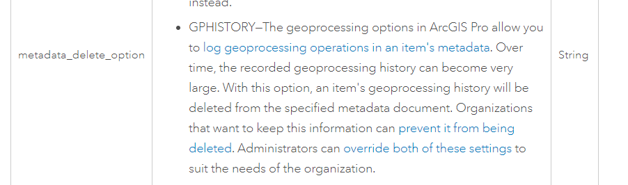

Have you looked at https://pro.arcgis.com/en/pro-app/latest/arcpy/metadata/metadata-class.htm

@KoryKramer- apologies for not responding sooner, I've been meaning to find the time to test this out. I've attempted to remove the GP history from an APRX file and using this approach doesn't seem to work (code below showing to 2 approaches I tried).
I did a bit of a deeper dive and it looks like the GP history is stored in the projects JSON (GISProject.json).
So really, I'd still like to see a solution available via arcpy OR via the project options.
