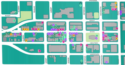

I have a map where I'm aiming to have several color-coded category symbols with key numbering inside the symbology rather than as labels -- I've done that in the past and found it a bit tedious so I thought I'd try this method. This was the example I was sent:

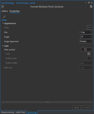

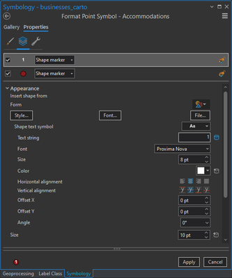

Now, my intuition is to use unique value symbology since my features are categorized into groupings and my categories are a text field (making 'vary by attribute' tricky), and then connect the shape marker text with my field, but I keep running into more tedious corners. If I go to format all symbol classes at once, most parameters are disabled. I can't really hook up the 'text string' field to the field unless I go one by one.
Multiple selected - very few properties appear even though the same style was chosen from the gallery for all layers:
One symbol class selected - the text parameter shows:
