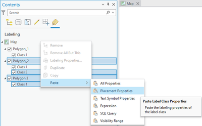

You can copy the placement properties from 1 label class, then select the 15 different label classes and paste the placement properties to all selected label classes. It will paste all label placement properties including the feature weights, but not the text symbol properties, SQL query, etc. so this might be an option for your situation, especially if you're not even labeling the technical documentation layers.
