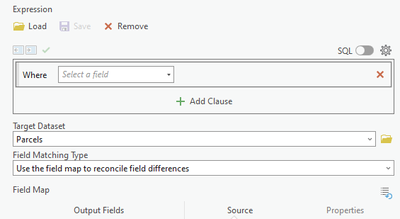

It would be great to have a "Save Field Map" option in ArcGIS Pro. This would function similar to the Load/Save expression that is available in tools like Append.
This would be useful for quickly recalling or recreating a field map that was used to reconcile field differences from a past geoprocessing tool run for a new target dataset that has the same set of fields (as the past exercise's target dataset) but different layer name or path.

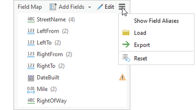

This Idea has been implemented in ArcGIS Pro 3.2.
In ArcGIS Pro 3.2, you find the option to load an already saved field map or export the field map as a string (.fieldmap) file. Please check out this blog to learn more about how to use the updated field map parameter in Pro 3.2.
