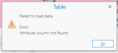

Recently, we tried the same approach with a PostGIS / PostgresQL Database with Query Feature Classes. Same schema "xyz", same data "test". If we replace the test-data with updated data with the same data design, it works fine. However if the data design changes (e.g. attribute deleted), the data can be displayed in ArcGIS Pro (currently 3.3.0), but the attribute table cannot be opened. the following error message is displayed: Attribute column not found.

it lists all attributes (attr1,attr2,attr3,...,attrN) instead of using the asterix (*). if the query is manually changed so that the asterix is used, the attribute table can be opened. However the query cannot be changed a priori or per default, which makes this workaround not  a usable workaround.
