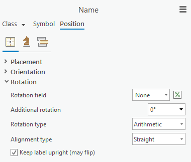

I have a line feature, with labels along each line. The labels are supposed to be horizontal - but rotated by 180° so they are upside down. However, it isn't possible to rotate the label itself or the symbol as it is e.g. for points:
Points:
Polylines:

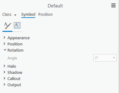

In the Symbol settings, "Rotation" is greyed out:
It would be great to rotate line labels as well - either by a specified field or a set degree.

As for the symbol UI - rotation is disabled in this case because the label algorithm controls the rotation, so this case would need to be modeled in placement.

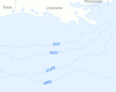

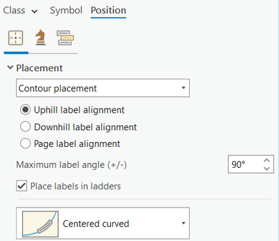

Here's another idea that may help label your lines depending on how your data is structured. When labeling lines you can use the Contour placement labeling placement style and specify the label alignment that works for your data. Here's an example with bathymetry lines.
In this case the depth values are positive so "uphill placement" places these upside down in this area of the map.
