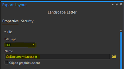

When exporting a layout I use different file types depending on the intended use of the document.  I normally define the file name and location of the layout being exported before thinking about the file type.  When I then go to change the file type, the name and location I just entered in the Name field is deleted.  Replaced by the original file name and location.  I then have to change the file name and location a second time.  Quite infuriating.
Please make it so that when file type is changed in the export layout tool the name field does not change except for the file name extension?

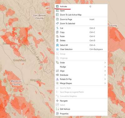

@DrWalkerS when you say  "I click off the export tab, fix the symbology, but when I click back to export" can you clarify? Are you clicking on a Map view to switch from working in your Layout view to working in a map?
If you're doing something like adjusting symbology, couldn't you do that directly from your Layout view? Like here
Or Activate the map and make any changes that you need to while you are still in the same Layout view?
Does that allow you to make the changes you need to on a map and retain the previously entered file name for the layout export?
