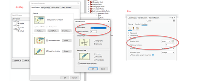

WendyHarrison
@MarcelSt-Germain
You can find the Rotation field option under the Rotation expander.  It is available for point features - the same as in ArcMap
WendyHarrison
MarcelSt-Germain
@WendyHarrison
Hi, I know that.  Can't understand why, but in my case it was unaccessible when making my suggestion.  After some other works, I retry and then it was accessible ?????

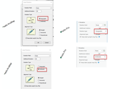

Bafut, the main problem persists.  The rotation doesn't work as expected.  In arcmap, if the pictogram was N-S so 0 degree, and a rotation of 45 degrees is applied, the picto move 45 degrees and the label fallow it at the same angle.  Now, the label doesn't fallow the picto.like in arcmap (same pictogram).  The label is with a strange angle.  To be able to leave the label in the same angle, I had to put an additional angle of 120 degrees.  The problem, with this additional angle, the label doesn't fallow anymore the positon setting.  Right or left of the pinto is translated in below.  Again, in arcmap with maplex it's working as expected.  Verry frustrating.
WendyHarrison
@MarcelSt-Germain
I'm seeing the same results from ArcMap to Pro.  Can you provide screenshots of what you're seeing?
