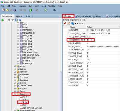

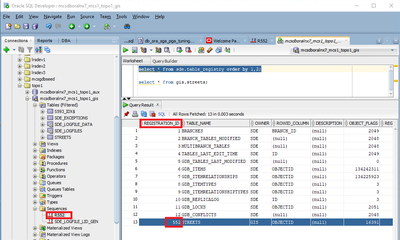

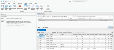

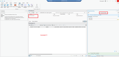

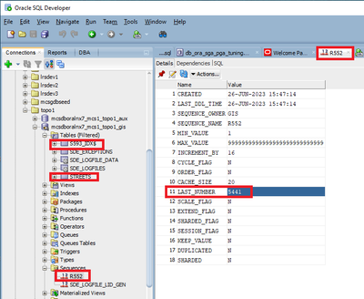

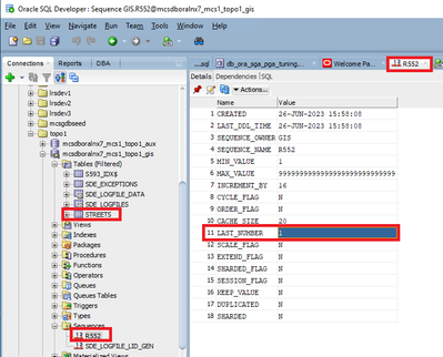

MarceloMarques
Indeed. I tested with Pro 3.1.2 just to make sure, and the "Truncate Table" GP tool does reset the "Sequence" back to "1". See screenshots below.
