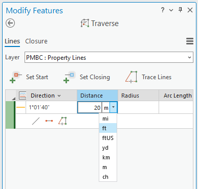

The idea would be similar to the way the Traverse tool allows the user to configure units per feature using a drop down in the row.

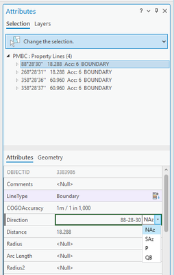

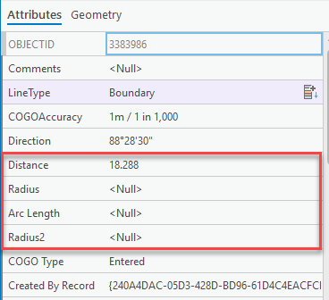

This same idea to specify units in the attribute pane would not only apply to the Distance field, but also apply to the other COGO enabled fields- Radius, Arc Length, Radius 2- to allow for user measurement unit configuration. The option to select direction units (Naz, SAz, P, QB) for the Direction field from an adjacent drop down is already available in the attribute pane configuration options. Why not extend this feature to the other COGO fields?

The unit picker for COGO fields in the Attributes pane is implemented in ArcGIS Pro 3.6.
Refer to the first bullet in the help topic.
