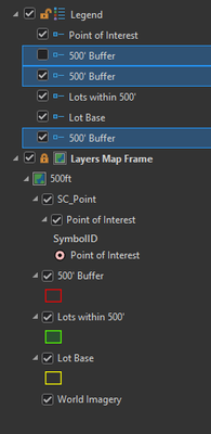

If you have the same layer in your legend twice, you cannot remove one without removing the other. R click > Remove removes both instances even if only one is selected . I'm sure this is supposed to be a "feature" but I propose removing only the entry clicked so I don't have to recreate the formatting of the entry or do some other workaround like adding another legend and moving it there.

@AubriOtisOk, I must have brought it in from another legend when I was experimenting with options yesterday -- that does allow you to have two entries from the same layer.
If I click Remove on one...
...both disappear:

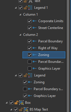

I have this issue in ArcGIS Pro 3.3.1 as of 10/1/2024.
In my layout, Pro decided to add two of the same items to my legend contents. When I try to delete the duplicate, it deletes both of the items.
Seems like the bug is still present.

Mine occurred when opening the geoprocessing history and re-running a buffer on the same layer with different parameters. When the operation concluded I had two different legend items for the same layer. Attempting to move/remove/reorder somehow duplicated it a third time.
Appears to be a different bug than the one ESRI linked to.
The only solution I have found is removing the affected layer from your map frame and then re-adding it.
