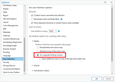

Hello @Bud , it's not quite what you want, but there is an option for the Table to open as a separate floating window. And between separate openings, it does remember the size and position you set the Table to.
KoryKramer
Chris is definitely pointing you to the right User Interface options. For specifically what you're showing in your video, it looks like the 'Stacked on top of the active view' would do that.
mbueno0
@ChrisUnderwood@KoryKramer
Changing the User Interface option for Tables is super helpful. Thank you!

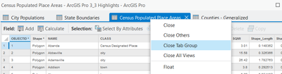

Another thing I would like to see regarding the Attribute Table/Attribute Table Pane is the ability to X out all the tables/field views/attribute tables in one fell swoop. Right now, each table needs to be closed individually.
It is helpful that the pane can float/move/etc., but I spend oodles of time X -ing out tables. There must be an easier way...
Do any of you know how to do this?
Thanks!
-Michael
KoryKramer
@mbueno0 Try 'Close Tab Group' by right-clicking on the tab.
