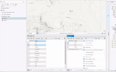

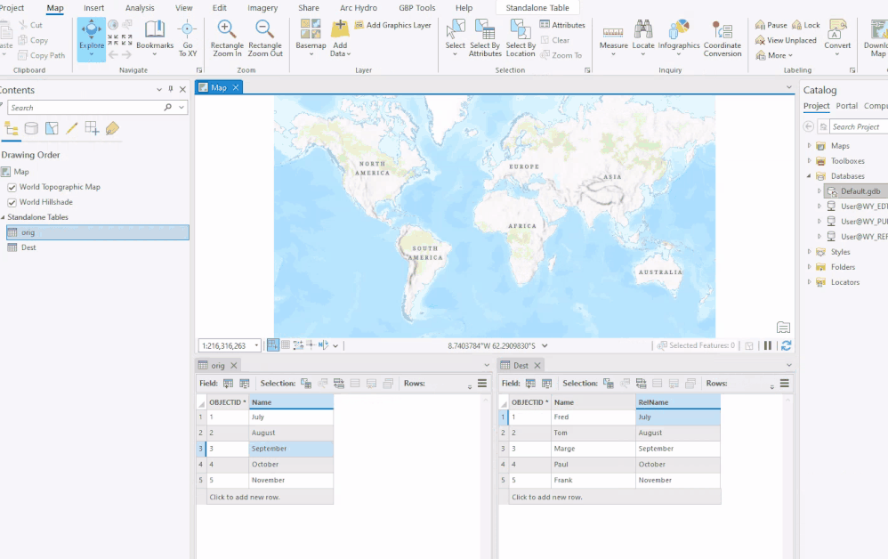

In the attached gif, I demonstrate how in a 1:M relate, you can view related records from the origin table, but you can't do the same in reverse from the destination table.
This is not a problem with a relationship class.
I can't find the post, but I asked about this a few years back and was told something like "M:1 relationships don't exist" or something.
