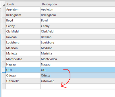

Hello,
It would be useful if we could reorder the domain code entries manually.  In the example below I would like to move "OOJ" to the last entry of the coded value domain table.
Thanks!
