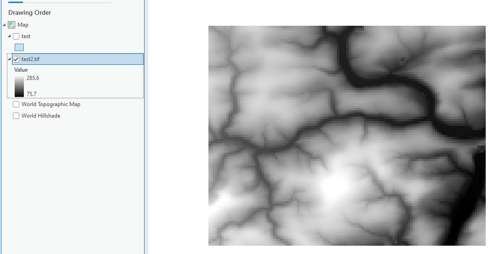

Whilst ESRI ruminate on this idea, are you aware of whitebox tools?
They have a tool that does exactly what you want RasterToVectorPolygons that will take a float raster.
Its free and has been exposed as a geoprocessing toolbox which you can download here.
You will be forced to accept it's limitations, for example it takes a tif as input and outputs shapefile, which are known to have size limitations.  I tested on a small section of a DEM which is float32
The result is:
I tried it on a larger section of DEM and it seemed to lock up but that was probably me being impatient. You might find if you have to process large rasters your existing work flow whilst irritating may be the fastest approach?
