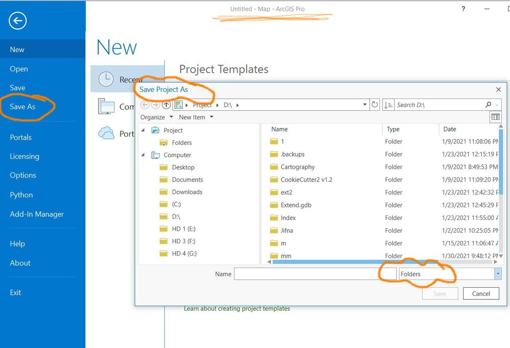

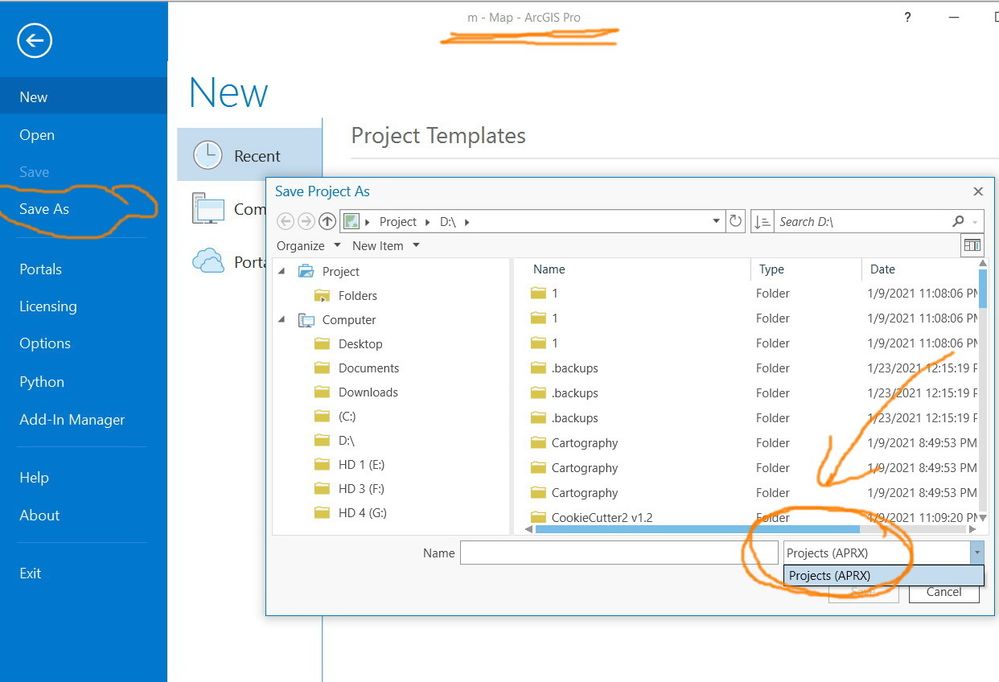

Unfortunately it's not in 2.7. If you "Start without a template" it still asks to save as a folder and not an aprx. ☹️ I don't understand why if you use Save As on an existing aprx it will save it it as another aprx, but starting without a template requires saving as a folder. The functionality is obviously there.
JamalNUMAN
That’s really very perplexing!

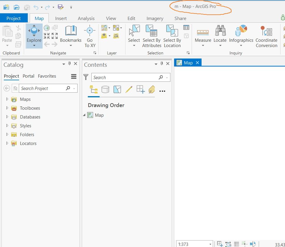

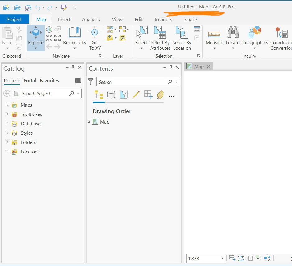

  • “Save As” an “untitled” map will get the aprx saved in a folder
  • “Save As” an existing aprx file will saving it as an standalone aprx file without the need to be saved in a folder
What could be the explanation for this behavior?
