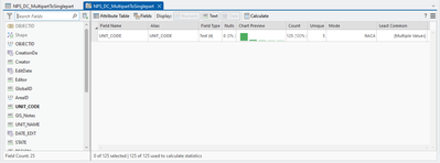

Hi @nheg! Have you tried using the Data Engineering view? Right-click on the field of interest and in the context menu chose "Explore Statistics". This opens the Data Engineering view which offers similar information to the window from ArcMap you shared above:
If you want a larger chart, you can right click on the "Chart Preview" field and in the context menu chose "Open Bar Chart".
Does this help?
