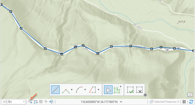

@ChristopherJStrong When an edit tool is active and you press the T key, a search of all snappable points (Point, Endpoint, Vertex, and Midpoint) within your defined snap tolerance (default is 10 pixels) occurs at the cursor location on the map with results displayed in a snap cache. You can limit the display cache results by disabling snap agents e.g., only enable vertex snap agent to show results of vertices on the line feature.
Snapping needs to be ON to display snap cache using the T key. One way you can show all vertices of a line is to increase the snap tolerance interactively  or manually typing  value in Editor Settings dialog so that the display snap cache covers the entire length of a given feature.
When snapping is OFF, hovering over a feature then pressing the T key highlights all vertices on that feature, similar to ArcMap behavior. I’d suggest trying if this works for you.

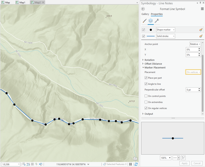

In addition to this, you can use marker symbol layer with marker placements at vertices along the line feature.
I hope this helps.

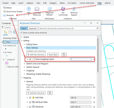

CarlosGutierrez4
Although I prefer the ArcMap method, it is nice to know you can do this in Pro.
@JMutunga, what is the name of the tool in Pro that displays the snap cache? I would love to reassign the shortcut key to the letter v.
Scott_Harris
@CarlosGutierrez4
You can change the keyboard shortcut here:
FYI
F12 key also gets you to the Keyboard Shortcuts dialog.
