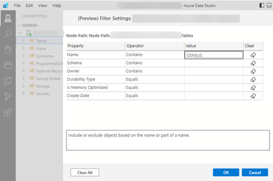

TimMinter
Indeed, this would be useful.  Much like we can do with ADS (Azure Data Studio) or SSMS (SQL Server Management Studio).
