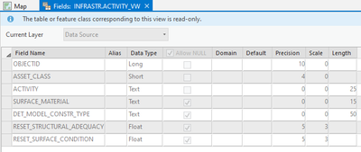

I want to be able to see field properties in query layers.
The option is currently greyed out, meaning that I have to go back to the source table(s) to figure out (for example) if that number column is actually numbers or text. Ditto to view domains.

To prove this point, we are able to see the field properties of database views in ArcGIS Pro (2.6.8):
Query layers and database views are normally treated similarly in ArcGIS Pro. So, like you, I would have expected the Fields view to work for query layers, just like database views.
As a last-resort workaround, I suppose you could temporarily create a database view from the query layer SQL, take a look at the Fields properties of the database view, and then delete the database view. That's pretty ugly though.

So, at UC today I asked about this and it looks like our not being able to see the fields of a Query Layer   from the Hamburger menu in the attribute table is a bug of some sort; you can view the fields if you to the Data tab, for example.
Hopefully this should get fixed!

@AlfredBaldenweck Interesting. Would it help to submit a case to support to get a bug report created?
AlfredBaldenweck
I did at UC, so hopefully I’ll get a phone call in the next week or two! The good news is that while I was explaining to Esri staff prior to filing a support case, we were able to replicate the issue in 3.3
