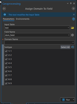

I can see why this would be very frustrating to do manually. This functionality is accessible by using either the assign default to field or assign domain to field geoprocessing tools.
When either tool is passed a class with subtypes, users are presented with the ability to select all, or a specific set of subtypes to assign the new value to. No nested python dictionaries necessary.  If a programmatic approach is more your style, this tool in combination with list fields or list subtypes, will allow you as much flexibility as you might need.
