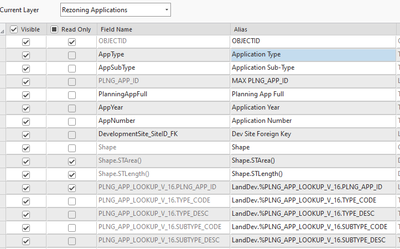

  • It doesn't matter how out create a join (*). Whenever you create join in ArcGIS Pro, and one or both parties is an un-registered table, you will see % sign in fully qualified field names.
    • having % sign in fully qualified field name is by design
  • The bug (BUG-000156380) was that when you publish that as a map service, and you make query using one of those field names (with % sign in it), map service query was failing
    • as you mentioned, typically you run into issues like when you add that map service in Map Viewer and you click a feature to see its attributes; popup window either shows nothing or fails.

Not to be argumentative @TanuHoque , but please see these screen grabs.  The first shows the resultant attribute fields when using a direct join and the second shows the join when using the table from the map. I suspect there is a bug in one workflow that doesn't exist in the other.  However, it does function "correctly" at this time.  Hopefully this method also doesn't break.
ScottAndersonMississauga_0-1717681722406.pngScottAndersonMississauga_1-1717681833028.png

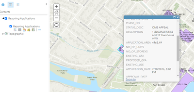

And the resultant successful pop-up in a Portal.

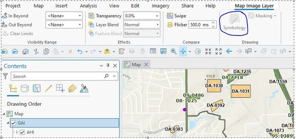

Wow @TanuHoque Thank you! I didn't realize I could add a layer off a map service as a feature layer. That could solve some problems. However, here are some things I am seeing:
When I add the map image layer service to ArcGIS Online or Portal Map Viewer I am able to change symbology. However, when I add the map image layer service to ArcGIS Pro 3.2.4 I am not able to change symbology - see below, greyed out. I can add an individual feature layer to change symbology but that's an added step that users might not understand. Is this by design? Is this a bug?

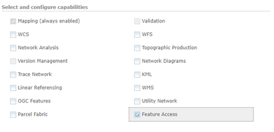

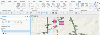

Exporting data from the map image layer service isn't possible. That would be nice if it were. Feature Service option -  ArcGIS Server manager: capabilities Feature Access - Extract -
Adding as a Feature layer from the Map image layer or using the Feature Service allows data export in ArcGIS Pro. Not sure where to find this option in a Map Viewer map or the Portal item page?
