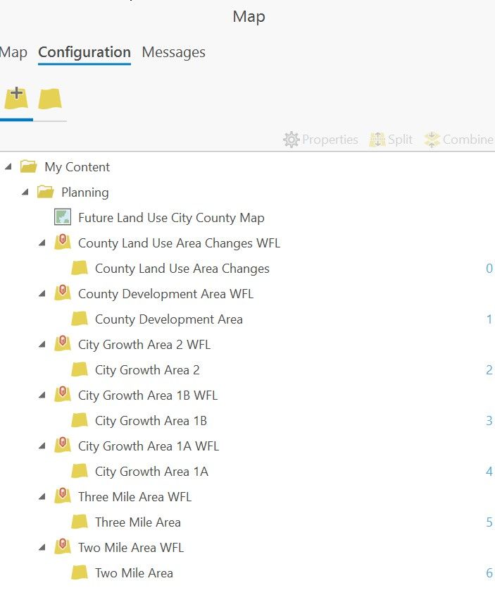

I realize that this is an old thread, but I agree 100% with the OP.  I get very tired of sharing one layer at a time via the dialog in order to have a separate feature layer for each feature class in the map.  I know there is the splitting option, but that is not at all useful in this case, as it still forces you to have a feature layer with one or more sublayers.  I want to end up with feature layer per feature class as it appear in Pro to end up in my contents pane in AGOL.  Thank you
JamiePetersen
Is this not what you are after?  I could be reading into this wrong.  I followed the comment above and it did work for me.  You share the map, make it copied to server instead of referenced, and split each layer from your TOC into it's own web feature layer.  I end up with individual rest endpoints for each layer, with exactly one layer in each one.
