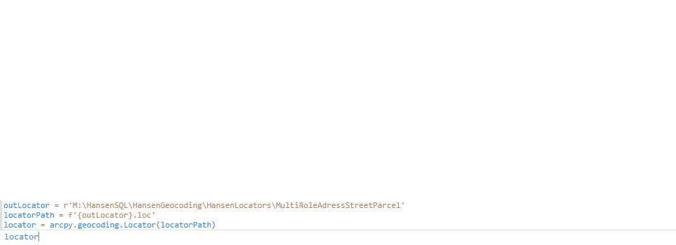

JoeBorgione
@BlakeTerhune  - I just discovered that what I consider an important property 'Match with no zone' cannot be set in arcpy, only manually.
Consistency is half the battle with creating locators especially if you are creating and recreating them on a regular scheduled basis. Any and all properties of a new style locator should available to to arcpy imho.
Here's a trick to show what properties can be exposed and/or set with arcpy.  Those marked with F indicate a function for geocoding, not a property of the locator itself:
