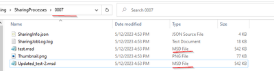

I have the same problem. It appears this isn't supported in ArcPy. I have tried using sddraft and the files are uploaded as a map package and not as a web layer.
On investigation, it would appear ArcGIS Pro (v2.9.2) is utilising .msd files under the hood when the Share as "Web Map" is invoked.   .sd files are not supported in ArcPy and were deprecated in favor of "sddrafts".
To verify, under options, navigate to "Share and Download". Open the staging folder and you will see folders for each transaction that include .msd files.
