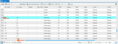

We agree that this is "No bueno" @RobertHursey and would be considered more of a bug than an idea since "when I make a selection, etc.  It should stay in place" is the designed and expected behavior. The dev team already has a related issue to look into a specific case of the attribute table "jumping" - in the case that they have documented, they have seen that clicking the row header (the gray box to the left of the row) causes the table to scroll to the first column.
Is that what you are seeing?  (Important note that I do not see this when working in 2.8.3 which is why I had to draw the arrow at the bottom because the table didn't actually jump to the first column).
When you are making a selection, are you making the selection interactively in the table?  Are you making the selection interactively in a map with the table open?  Or are you using the Select by Attributes tool to make the selection?
And when you say that the table returns "to the start, top, bottom, end, etc." does it return to the start of the table (I interpret that as the left-most column), the top (first row), bottom (last row), or end (right-most column) in different circumstances?
It will be necessary to get specific details in order to understand the cause and fix it.
