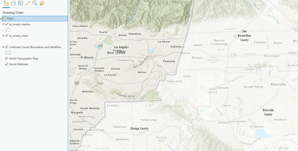

SaraBangen
@WendyHarrison Agree with others this should be implemented.  Others have provided examples, but I'll also provide one here.  The counties layer is below my mask layer in the contents pane. But the county labels are being drawn on top of all layers.  The labels should be drawn at the same level as the layer, not on top of all layers.
