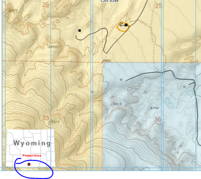

Has the label extent indicator feature been added? I often produce map series with sites that are in different, sometimes 50 to 100 miles apart, the extent indicators are typically collapsed to a point as shown in the picture below, but I would like the label to be associated with the indicator point so it moves with the point across each map in the map series. Is there a way to do this?

JamesPoeschel
It's a shame this is still not in consideration.
This would be very nice to have when you have a map series with an inset map and extent indicator.
A work around is to have labels on in the inset map, and instead of having a color fill for the extent indicator (since the labels would appear under the indicator box), it'd just be a transparent fill with a colored border.
