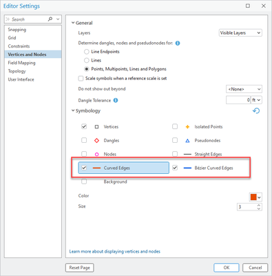

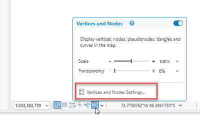

Hi @RTPL_AU This is possible at ArcGIS Pro 3.5 by turning on Curved Edges and/or Bezier Curved Edges within the Vertices and Nodes settings and enabling it in your map.

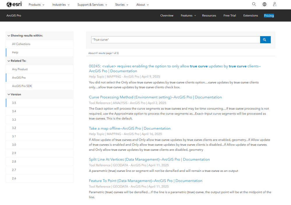

Quick question - How far down the page should I go when searching for True Curve in the docs 🤣🤣🤣

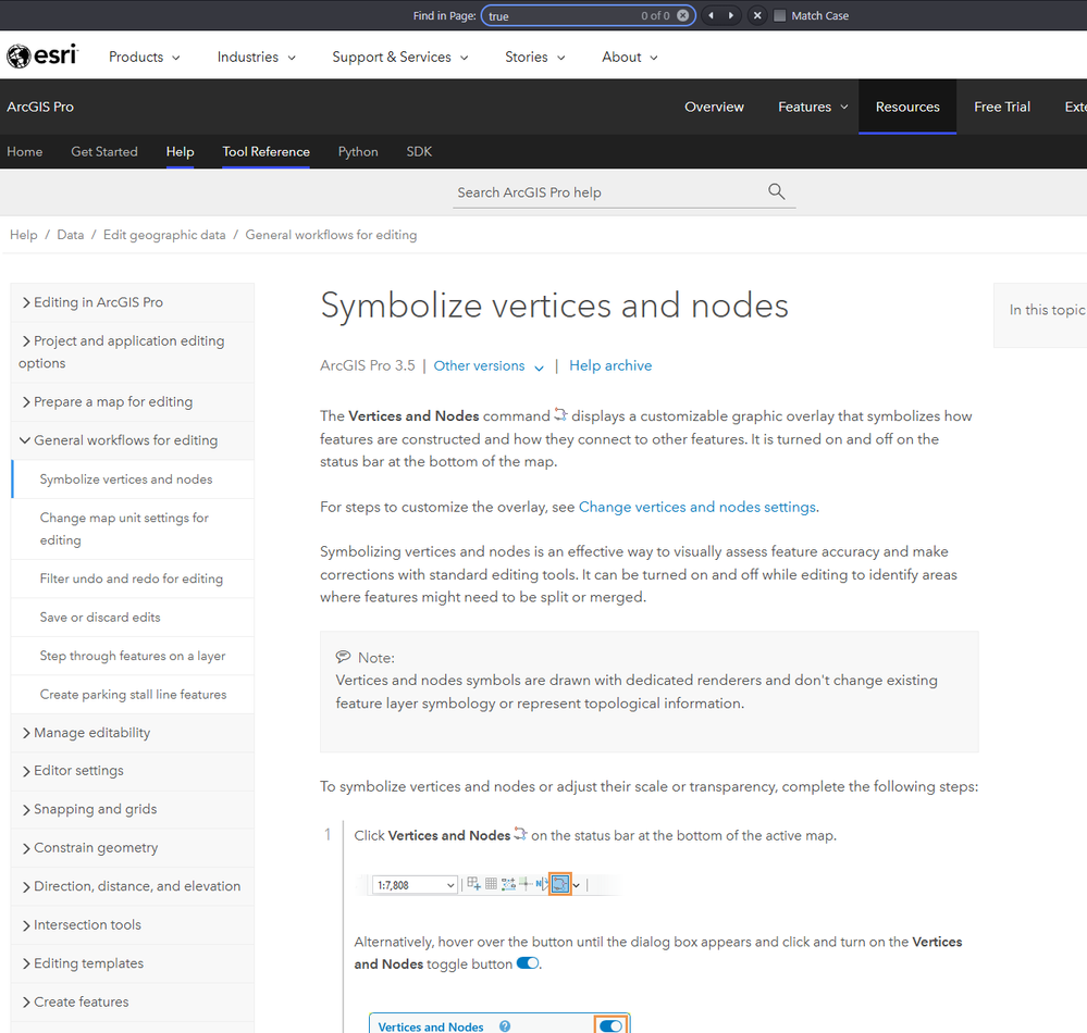

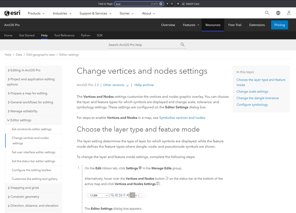

I tried 'true' in the docs you referred to:
It also is not listed when you search for True /  True Curve in Pro's Command Search.
I'm not lodging another Idea to improve the search and/or documentation. That is a standing order that I hope someone at Esri is taking to hart.
