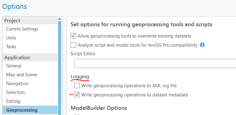

What happens if you go to project Options > Geoprocessing and check on Write geoprocessing operations to log file and dataset metadata?
2.0.1
It looks like that gets a little redesign for 2.1, with Logging split out and writing metadata as default:

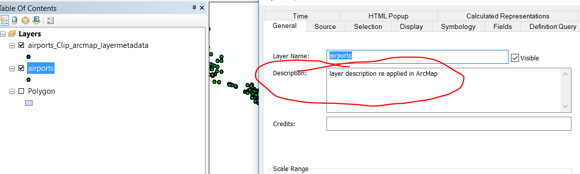

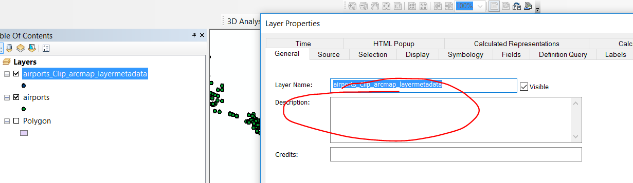

I quickly checked the behavior in ArcMap - even when I have some metadata in the layer
when I run Clip like suggested in this idea's description and look at the output layer (not data source) it is blank.
But the metadata from the data source is carried through into the output feature class' data source.
