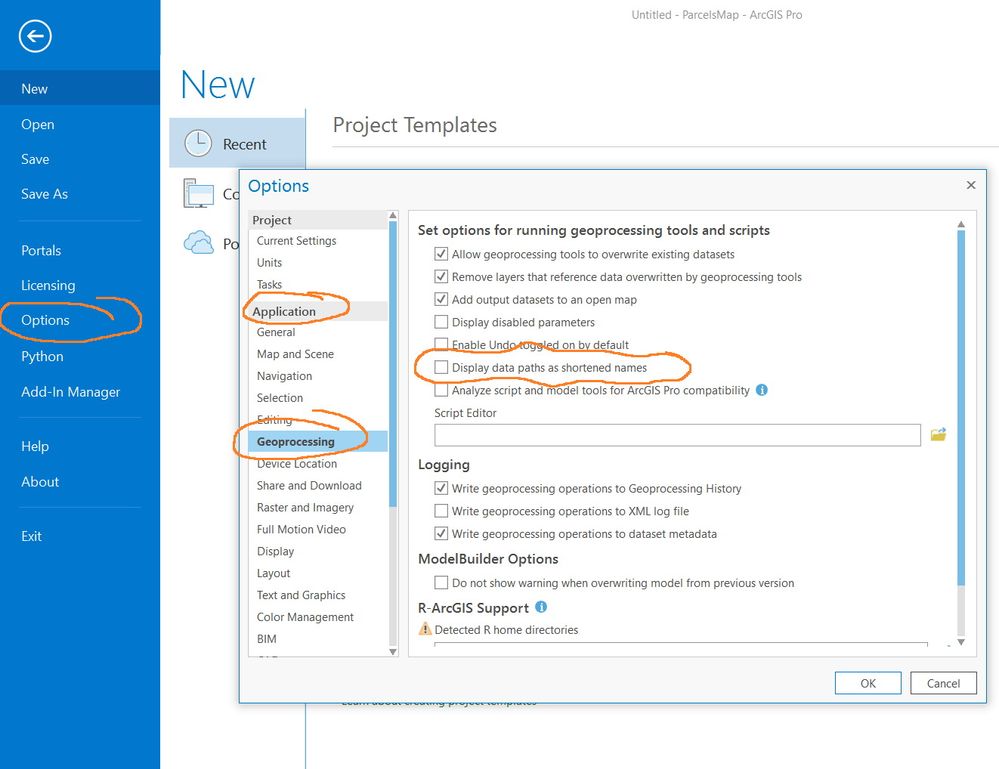

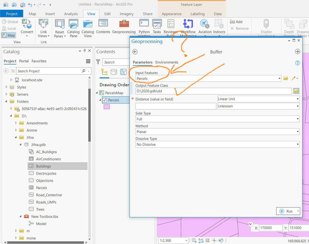

JamalNUMAN
Right but how to display the path of the input as well?
KoryKramer
Hi Jamal,
It looks like you're adding the layer (from the Contents pane) as input to the tool, rather than the data source (from the Catalog pane or view, or by browsing to the data source).
Here is a screenshot from ArcMap when I add the layer - the tool's input displays the layer name:
And when I add the data source:
The geoprocessing setting in Pro makes the display path behavior work the same.
