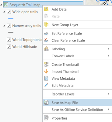

In ArcGIS Pro, you can indeed open a .mapx file, work on the map, and then save the map back to the same file – when you save a map to a map file (https://pro.arcgis.com/en/pro-app/latest/help/sharing/overview/save-a-map-file.htm), if you select the existing map file in the Save Map As MAPX File browse dialog, you will be prompted about overwriting the existing file, and if you say Yes, you will be saving the modified map back to the original .mapx file.  (Same with layout .pagx files, through the Save Layout As PAGX File browse dialog.)
Note that this can be saved directly from the map's context menu without going to the Share tab > Save As group.
