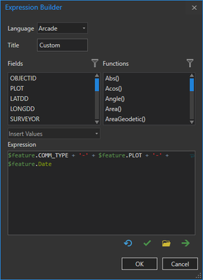

Pro seems to respect this convention in the attribute table, in that the timestamp is not shown if it is not populated in the date field. It also does not display the timestamp in the Display if the timestamp is not populated and the date field *is* the display field by itself. But, if that same date field is used in a Display field expression within layer properties, the timestamp is displayed even if it's not populated.

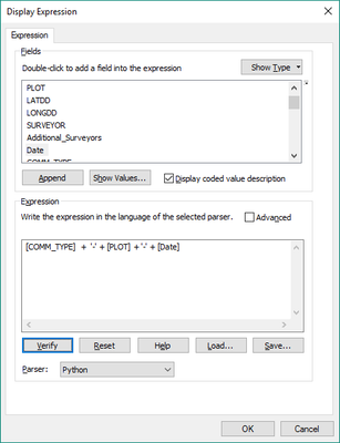

I'm not sure if there's something I'm fundamentally not understanding about Arcade expression and/or timestamps but this also seems like it could be an oversight. Here's what my display expression looks like in ArcMap:
Sample result: Central Appalachian Basic Ash - Hickory Woodland-ALBE013-05/09/2011. This is the desired outcome since the timestamps are not populated in the date field.
And in Pro, on the same dataset:
Sample result:
This is not the desired result and different from the behavior in ArcMap.
