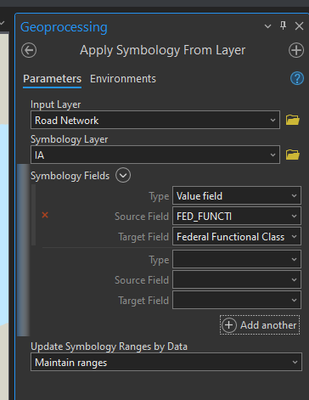

The Apply Symbology From Layer tool is one of many GP tools that I've found does not fully support the keyboard as a means of input. Specifically, if you need to add more than one symbology field, you're out of luck -- tab/shift+tab skips right over subsequent Type, Source Field, and Target Field fields after the first set. The focus stays on 'Add another,' but shift+tab moves the focus to the Target Field of the first set of fields.
It would be nice if this supported keyboard access as many have come to expect and rely on.

@wayfaringrob your Idea related to the Apply Symbology From Layer tool's Symbology Fields parameter has been merged with this idea.
Keyboard navigation/tabbing through multivalue and valuetable parameters has been implemented in Pro 3.2.
