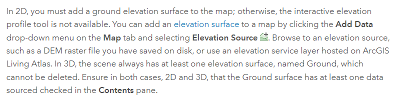

Anyway, what I do need is something like the old school Profile tool from ArcMap. You select the DTM in the tool, you draw a line (always on map view), you press the graph button and voilà, you got your topographic profile. We don't need fancy thing, just a quick way to do a simple profile. Still have to open ArcMap for doing it. I am surprised that Pro misses such a basic tool. With that said, maybe this works as fine (and maybe better): https://pro.arcgis.com/en/pro-app/latest/help/mapping/exploratory-analysis/interactive-elevation-pro... but can't find it. Thank you very much.
KoryKramer
Thanks for the response @Simonez If all you need is a way to create an elevation profile, the current tool will work for you. From the help that you referenced see this paragraph:
Have you added your DTM as an elevation surface to the map? Once you do that, you can find the Elevation Profile from the Exploratory 3D Analysis split button.
You may also be interested in this idea about adding a raster layer to the elevation surface https://community.esri.com/t5/arcgis-pro-ideas/add-a-use-as-ground-entry-to-the-single-band/idi-p/10...
Hope this helps.
