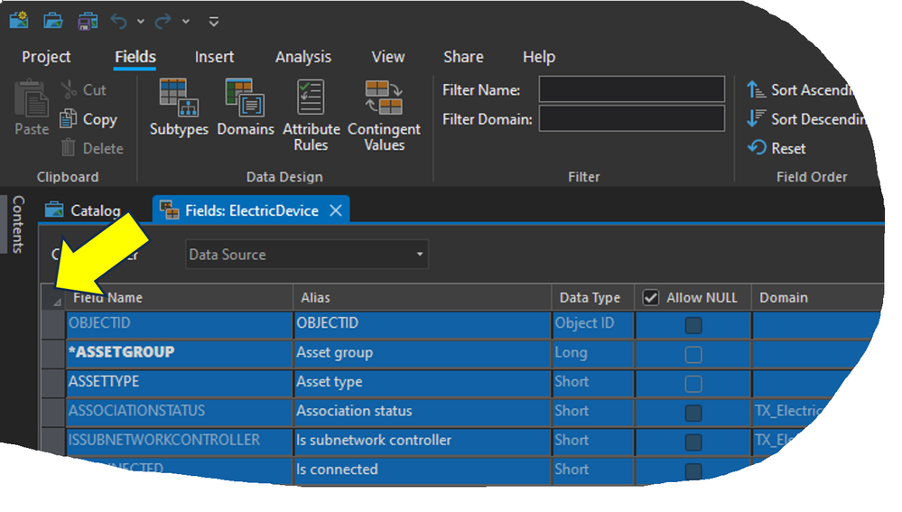

RobertNunez
I'm sure you (all) probably figured this out by now....(not sure how it worked in any version prior to 3.1.4)
1. When in ArcGIS Pro
2. (in the Catalog tab) navigate to and right-click dataset having the schema you want to print. -Then  click "Data Design" -> "Fields"
3.  After the Fields tab populates, click the small box (to the left of the [Field Name] column. (the one that has a little triangle on the lower right side of the box)...The whole table should highlight in blue.
4. Click Ctrl+C (on your keyboard) to copy the data in your clipboard
5. open Excel (or any other document)
6. from within Excel, click Ctrl-V (on your keyboard) to paste the data...
-Done-
