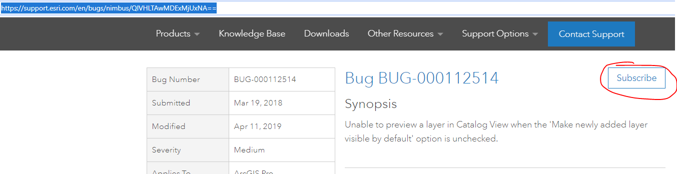

You can go to the bug on the support site: https://support.esri.com/en/bugs/nimbus/QlVHLTAwMDExMjUxNA==
And click the Subscribe button:
This will help with 2 things:
1. You will get notifications of status updates.
2. It will increment the count of customers watching the bug which helps to prioritize it.

alex_friant
Thanks for teaching me about that feature, I never knew that was a thing. Cheers!
