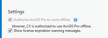

ArcGIS Pro determines which named user took the licenses offline - it is agnostic to the Windows user’s password.
Since you have a case open with Technical Support, you could work with the analyst to go to the portal manager (ArcGIS Online or Enterprise organization from which the license was checked out) and determine the username that took the licenses offline and the machine (Pro alias).  If it’s on the same machine, verify that another user did not take the license offline. This could be the cause, though we would need the above investigation to be done. It is still possible the offline license became corrupt for an unknown reason.  We are not ruling that out.  There’s just not enough information to make that assumption.  However, changing the Windows’s password should not affect the offline license.

FWIW I just took a Pro license offline, then changed my Windows password. Signed out of my machine, signed back in and Pro opens fine.
So changing the Windows user password in and of itself has no effect on the offline license. There may be something else going on, so if you and your colleagues find that something about your environment/licensing setup is disrupted by changing a Windows password, please do report that to Technical Support to be investigated. Thanks
