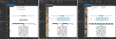

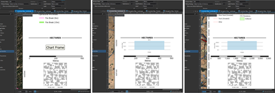

The problem I find is that many of our maps have such variable scales, that no single existing setting gives a nice outcome all the time (typically when using a Map Series). Some examples below show how the scale bar responds at different scales based on the Fitting Strategy selected.
Adjust divisions and division values
Adjust number of divisions (my preferred option for a nice looking scale bar)

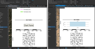

IDEA: When using "Adjust division values" or "Adjust divisions and division values", allow the option to round intervals to a user specified value (e.g. nearest 10, 50, 100, 200, 500, 1000, 5000, etc) AND/OR allow the user to create specific interval values (in a list) for the scale bar to use at different scales (in a similar way to the way the map scales can be customised as per the below screenshot)
Having this level of control would mean that regardless of my map scale (1:5,000 or 1:40,000), my scale bar will present nicely configured division intervals and will still fit within the specified space on the layout (fixed width).
With this sort of function, I could generate maps that look like the below instead of the above.

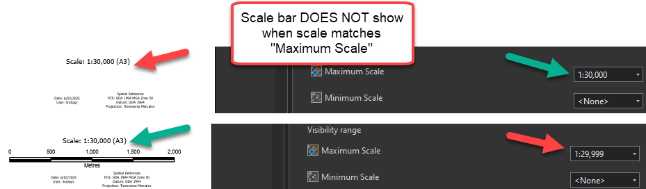

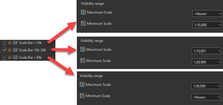

Hi @JesseWickizer. Yesterday I ran into a small "bug" with the new scale bar visibility features. I'd spent some time creating a set of 3 scale bars with different Visibility ranges (<1:10000 / 1:10k - 1:30k / >1:30000). For the middle interval, I had the scales set to 1:10001 - 1:29999 with the upper and lower bars set to the round 1:10000 (Min) & 1:30000 (Max) values.
However, the problem was that the scale bars weren't showing up when I zoomed to a "Max" scale value.
TODAY however, I went back in to get more screenshots for this post, and now they work as expected.
So, instead of asking for guidance around whether this should be logged as a bug or is expected behaviour, I'm instead going to suggest that you use thresholds that are unlikely to never be used, instead of clean breaks like I have, JUST IN CASE!
JesseWickizer
There's a Map property on the General tab called "Draw up to and including the maximum scale in scale ranges" that you can use to control how layout elements (or layers or label classes, etc) draw when the map scale matches one of the visibility range values.
By default in Pro, new projects have this property unchecked and it's recommended to set the Minimum scale property of the smaller scale layer and Maximum scale property of the larger scale layer to the same scale. Imported MXDs have this property checked on as it was more common in ArcMap to set the scales offset by one like in your example.
In your case since you're setting the neighboring scale values to be offset by one, check on this property and the scale bars will draw correctly when the map scale matches one of the visibility range values.
