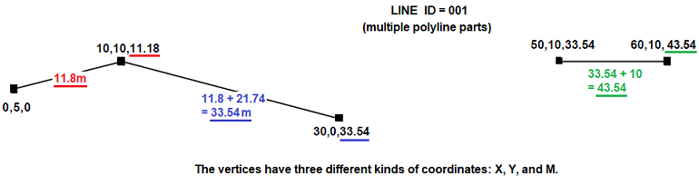

As far as I can tell, the Points To Line GP tool can’t be used to create multi-part polylines:
ASSET_ID     PART_NUM VERTEX_NUM          X          Y          M
001                 1          1          0          5          0
001                 1          2         10         10      11.18
001                 1          3         30          0      33.54
001                 2          1         50         10      33.54
001                 2          2         60         10      43.54
Could support for multi-part features be added?
