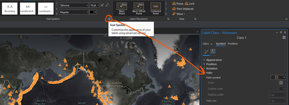

@LyonMNGIS since the halo properties are not a command, it doesn't feel like this should be part of this idea thread. I think it would be most effective to post your specific request as a new idea with the 'Annotation & Labeling' label.
For now, (you're probably already doing this) you'll just have to use the dialog box launcher to get to the halo properties expeditiously.
