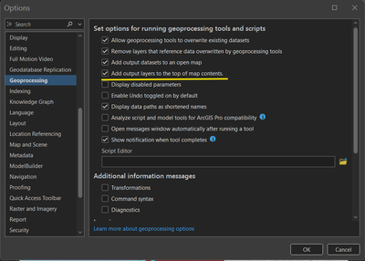

Have you played around with the Geoprocessing Options?
In the options dialog box under the Geoprocessing tab is the option to tick/untick "Add output layers to the top of map contents". Is there a chance that you have this box ticked?
RandyMcGregor_BMcD
I don't have that set and new layers come in at the top.
