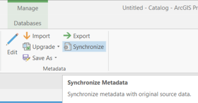

Use the Synchronize button:
There are the following help topics which provide further details:
https://pro.arcgis.com/en/pro-app/latest/help/metadata/view-and-edit-metadata.htm#ESRI_SECTION1_4B54...
https://pro.arcgis.com/en/pro-app/latest/help/metadata/update-item-properties-in-metadata.htm
Thank you!

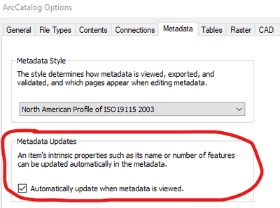

Thank you @KoryKramer  for the information. However, I am looking for something like the functionality that ArcCatalog has were you can check a box in ArcCatalog Options to have that sync run when you view the metadata.
Thank you for the information on the Synchronize. That helps but I like having the option to have that sync happen automatically. Do I need to change the name of this idea to make it more clear? Also, can you please unmark this as "Already Offered"?
